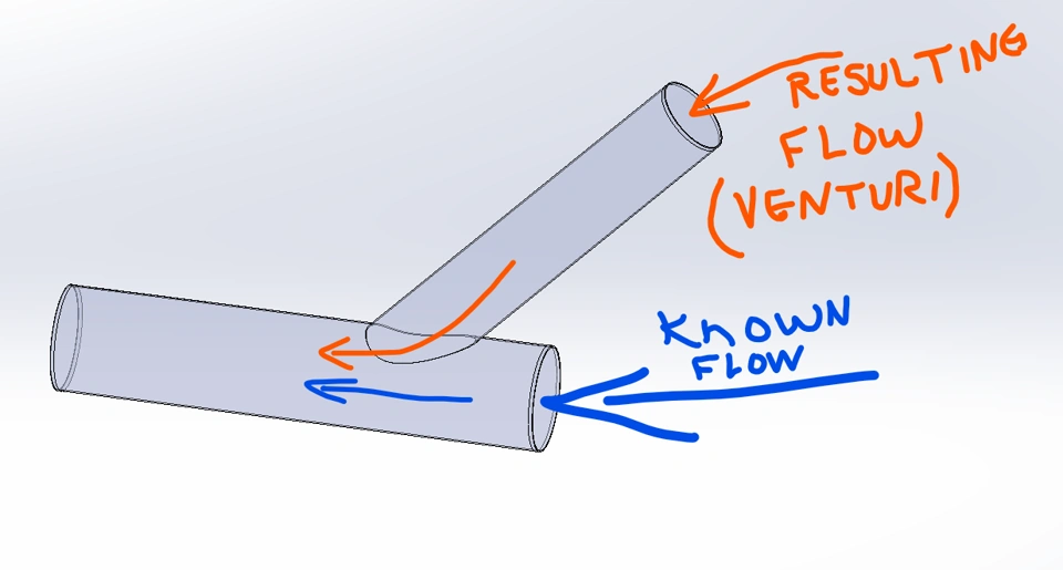

"Venturi" result - Is it possible?
 Can Flow Simulation model a simple venturi application as shown in my simplified pic?
 In a very early version of Flow Sim (v2004) it could not, I am now finding myself asking the same question in v2025.
I would enter the known flow velocity or volume and like to know the result of what is drawn into the open tube.  I have tried this with the Wizard but am not having success.
