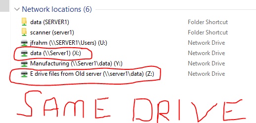

Another issue is inside Solidworks I can not find mapped drives. I had to remap to the drive where my files where backed up. So now in Microsoft Explorer I have two network locations to the same place.
