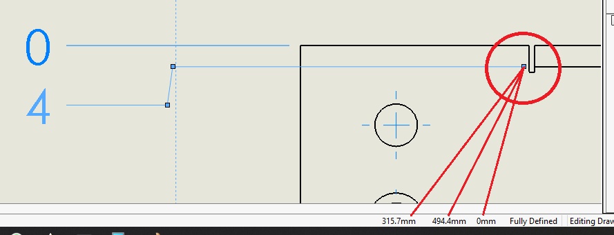

I am working with ordinate dimensions and I would like to get the position of the dimension tail end in the drawing.
I can currently get the position of the annotation but I am looking to find the drawing point where the ordinate dimension begins (where the pointer is in the picture in attachment) so I can decide to break the dimension whenever this position is beyond the center of the drawing view.
Any suggestions?
