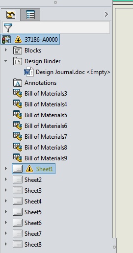

I use a simple macro i found here in the forum. https://forum.solidworks.com/message/706196#comment-706196 from . I have a Drawing with 7 different BOMS in the tree, i needed them to all be deleted. I believed this used to work, but for some reason it is only deleting one BOM now. From what i know it should continue till the swFeat = nothing, aka end of the feature tree.
