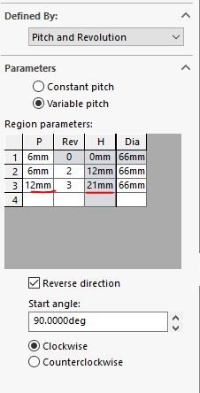

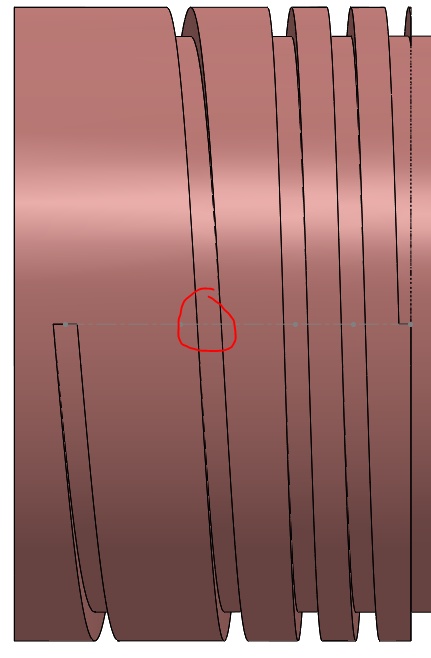

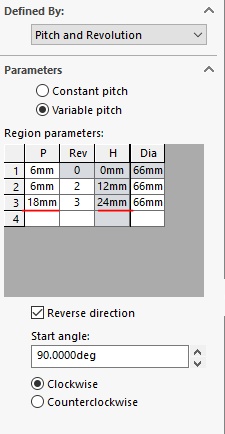

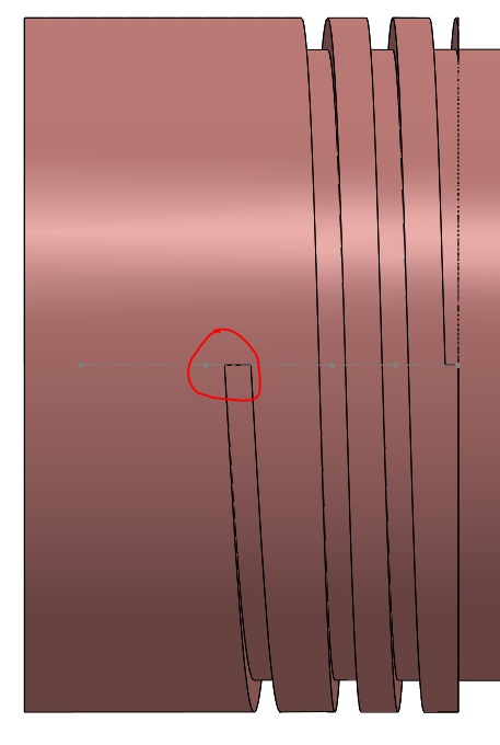

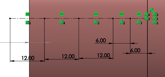

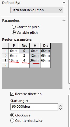

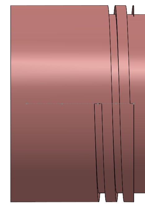

I am having trouble recreating this pitch on a feed screw.
It starts with two 6mm pitch revolutions, than goes to 12mm revolutions (3 total). I can get the helix to work from 6mm to 12mm but from 12mm to 12mm always messes up the rest of it.
Below is how i am trying to set it up, not sure what I am doing wrong.
