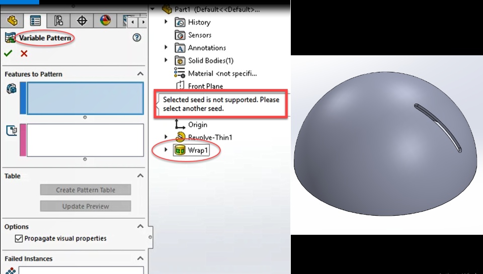

Variable Pattern and Wrap
Wrap feature is not supported by Variable Pattern Tool. How to fix it?

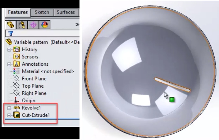

In the tutorial extrude cut was used.
