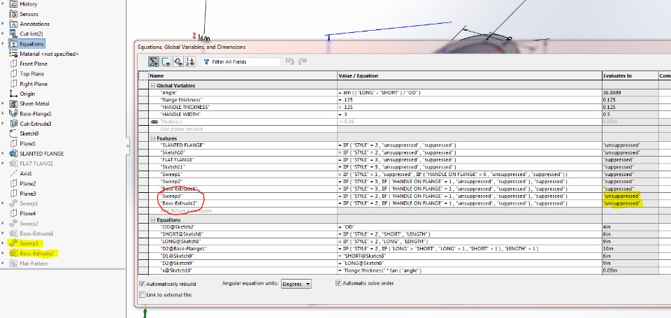

usuppressed feature in equations not updating on the FeatureManager Tree
Hello everyone,
please see the screenshot:
The problem I am having is that, even though the equation evaluates correctly to unsuppressed for the features highlighted, they stay suppressed.
I tried, rebuilding and changing the solve order, but i keep having the same problem.
I can unsupress those features only manually if the conditions in the equation are satisfied.
any ideas why this could be happening? This is on SW2016 SP4.0
Thank you!!
