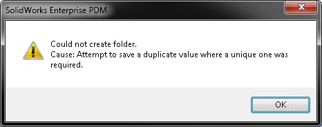

If I enable the Project Number variable mapping on the Files and Folders section of the Template Wizard, (Select Project Folder ->RMB ->Properties->Copy Variables) then get out of the template and attempt to create a new project in the vault,  I get the following warning:
This results in the folders not being created.
I have tried not having the Project Number as part of the folder and this didn't change anything. Is there something special you have to do on the Template or Folder data cards to accept the value when the variable is 'unique'?
