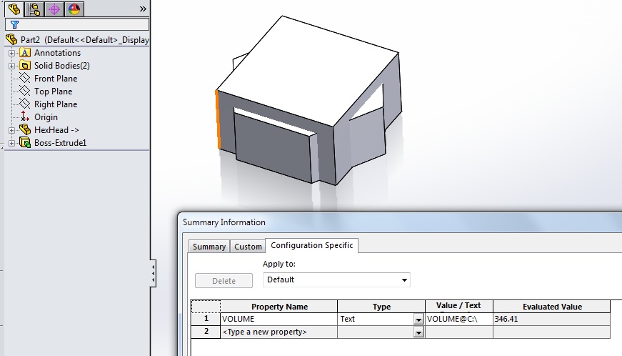

In my first simple case I would like to construct a cube the same volume as an extruded hex.

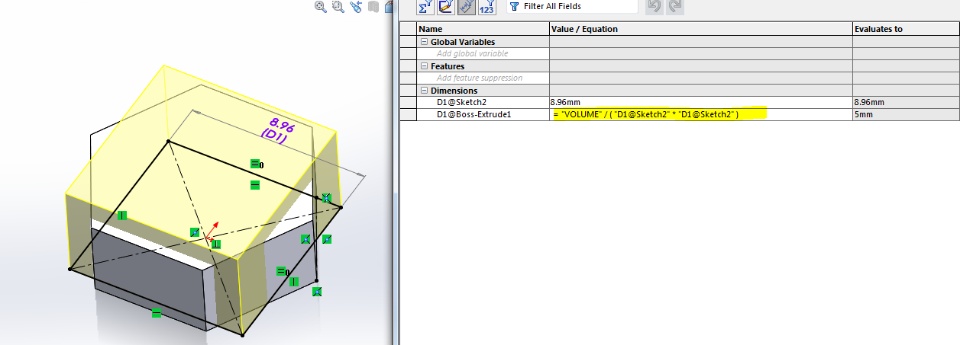

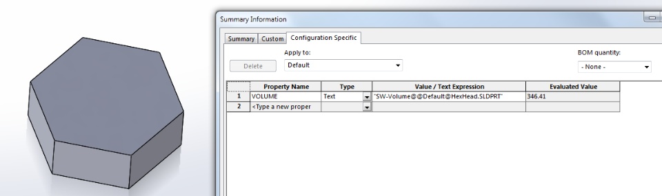

I made a base part and added a property equaling SW-Volume, I then inserted this into another part with the custom property hoping I could use this in an equation, but Solidworks will not accept it.
'The Syntax of this equation is Incorrect'

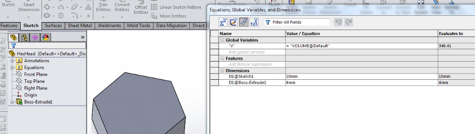

I narrowed it down to the custom property, in the base part I can use it no problem, for example here to create a global variable
but not in my second part

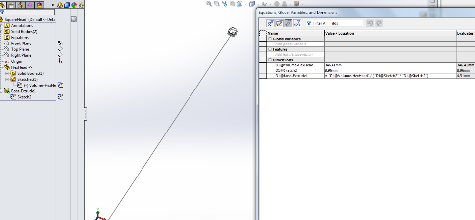

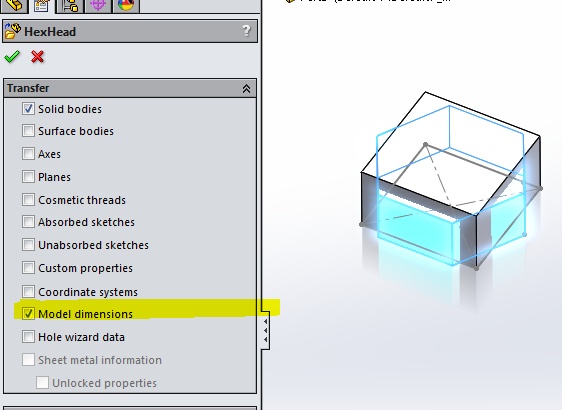

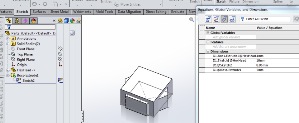

So I thought I'd go with that instead and use model dimensions
but alas no global variable came through, just the sketch dims
For this shape I know I could just do the math myself (I'll probably just add a new unabsorbed sketch) but I would much prefer to learn. It seems like there must be a much better way.
edit: Unabsorbed Sketch works, but for me it's one of my daft work-a-rounds.
Why doesn't my first attempt work? (I'm thinking SW recognises the property as Text) Can I do this all in one part? Is it possible to exclude some bodies or features from the volume calculations within a part? I suppose I would like to know when the Volume is calculated. In this situation it would be nice if I could use SW-Volume in Equations and it gave me the 'current' volume at that point in time during the rebuild, but I imagine that would also cause more problems..what If I add features later. Circular rebuilds and errors!!
