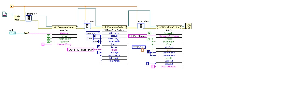

I am having trouble with IEModelView: OpenDoc
Arguments:
FileName - C:\\etc... filepath datatype converted to string datatype.
IsTemp - False
PromptToSave - False
ReadOnly - False
CommandString - (I've wired an empty string to this
For my application I need to print certain drawings (programmatically) from a shared drive. Most of these drawings are .DWG or .pdf. However, there are some drawings in the .SLDDRW format. I downloaded the free eDrawings 2012 from Solidworks in order to achieve this, but I've been running into problems with the OpenDoc method.
When LabVIEW gets to the invoke node, it "hangs," - it doesn't execute further and the VI cannot be stopped (I usually have to force-quit it with Ctrl-Alt-Del). In my code I have 30 s time delays (probably not necessary, was just making sure that eDrawings had time to finish the command) and "
