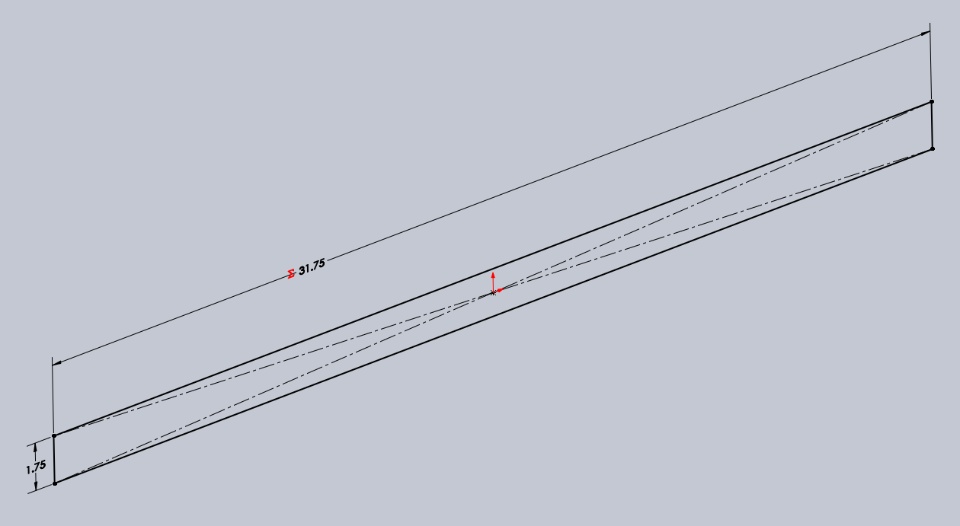

I make a Base Flange and the sketch uses that global parameter. No problem there.
