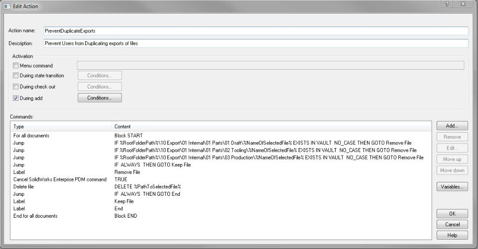

Hello,
I am looking for a way to use dispatch to find a file that is in one of three directories and if not found, then end without error.
I am already copying released PDFs to an archive folder and deleting them from the original.
Any help would be appreciated.
