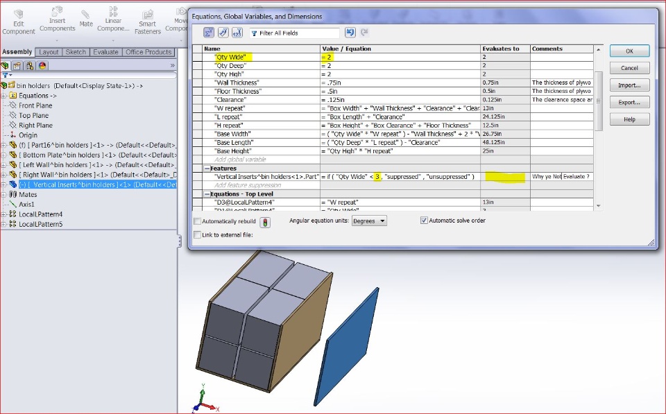

Hello There,
So I am trying to use global equations in my assembly, to suppress a part. Is this possible ?
Is a part not a feature in this case ?
All the parts are virtual within the assembly. Is there a way to control the instances of a part with equation wizardry ?
Also, If it was going to work, I would expect to see something in the "Evaluates to" column ?
Thank You !
