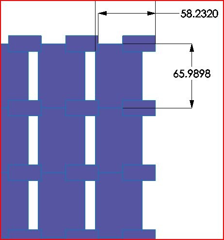

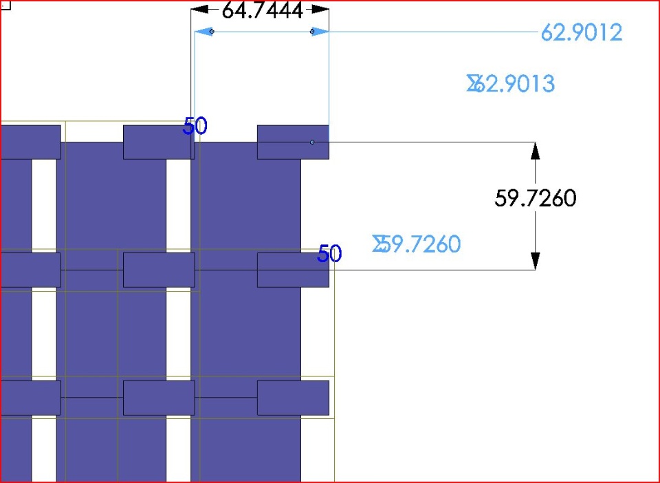

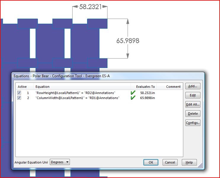

is it possible to use a sketch dimension of a part to drive anassembly component array spacing? thus the distance dimensions ofthe array?
i have a component array whose spacing is dependant on the size ofthe part. the part has multiple configs driven by a sketch dim.
i wish to do this in a design table as well.
equations do not seem to update properly.
any thoughts?
