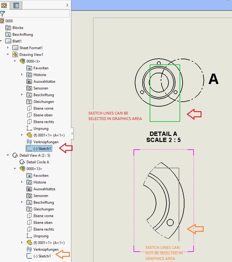

Issue 1:
In any projected view I can make the sketch visible. I can select individual sketch elements
to convert them. Here comes the issue. I can't do that in a detail view. I can select the whole
sketch in the feature manager. But I can't select individual sketch elements.
Lines, Sketches only the most simple stuff and SW fails!!
Workaround: Convert the whole sketch onto a dummy layer. Move the items I want onto another layer and delete the rest.
