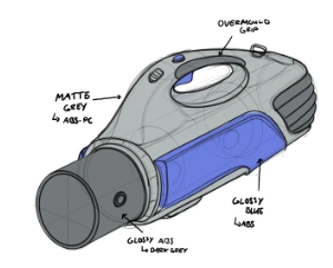

Below is my original sketch of the blower.
