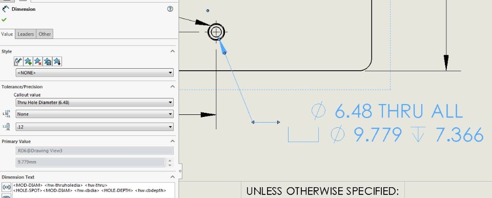

Updating decimal places in hole callout
I am trying to update decimal places to a two-place value (X.XX).  There is a thru hole thru a counterbored hole.
I want to modify the dimensions to be either one or two decimal places.  It currently reads:
Ø6.48 THRU
Ø9.779 C'BORE X 7.366 DEEP
I want it to read:
Ø6.48 THRU
Ø9.78 C'BORE X 7.4 DEEP
I have updated the Tolerance/Precision to ".12".  At that point, it updated the Ø6.48 but did not change the other 2 dimensions.  What is causing this?
Is there a way that I can modify this instead of manually inputting the values (9.78 & 7.4)?
