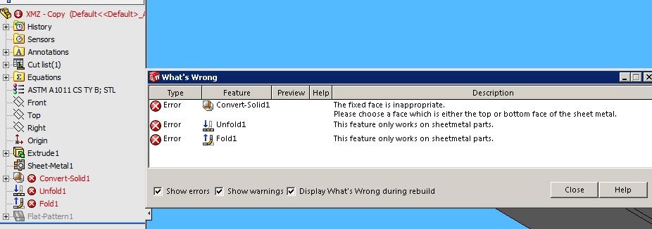

I have a problem that has been stumping me.  We are finally updating from SWX'08 to SWX'14 SP5 after a long road implementing a new PDM system.  Anyway, I have a sheetmetal template that is giving me fits.  After the up-convert to 2014, it gives rebuild errors on 4 of the features (see attached screen shot).  I have tried to update the features and remove the legacy features, but I still get rebuild errors after rebuilding, saving, closing, and then reopening (see second attached screenshot).  I will attach the original .prtdot (XMZ) and the .prtdot that I attempted to update (XMZ-Copy).  The kicker is that I have to keep all of the features of Extrude1 due to existing macros.  The face picked as the fixed face is the one attached to the origin.  Any help would be greatly appreciated.
