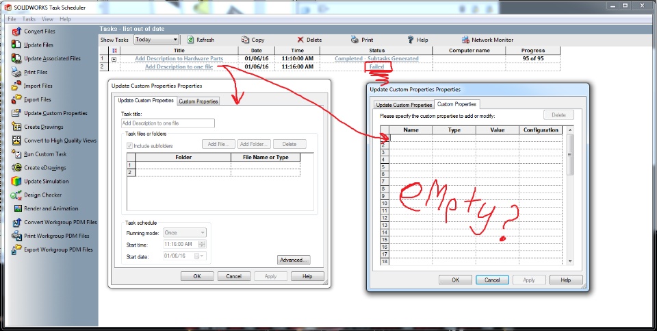

Update Custom Properties - How do I use it?
I have tried to use Update Custom Properties, but cannot get it to work.
I add a task and it runs, but fails.
It seems that the information I enter into the Update Custom Properties window erases itself and becomes empty???
I tried it with a folder first (silly me), then tried it with one file.
SW opens, if it is not open, then shuts down and the TS says it has failed.
What am I doing wrong?!?
I edited the Task Title, Please add description to one file.
I Added File, .375X.625-SPACER.SLDPRT. [Is it the full stops? Does TS not recognize that as a valid filename? i will try another file.]
I changed the start time to a future time.
NEXT
I selected Description, Text, and added a Value of \\\$PRP:"SW-Configuration Name".
FINISH
I waited for it to run. It ran. FAIL.
SolidworksTask Scheduler
