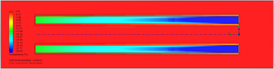

1st heat ex-changer with a hollow inner tube;
Analysis seems ok

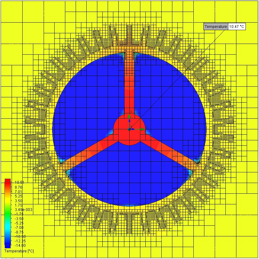

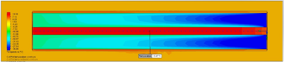

2nd heat ex-changer analysis;
It's very warm in the center shaft, approx 10.5 deg C. Should it go over the ambient temperature of 2 deg C?
