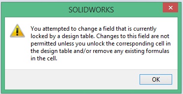

It does what it should do, BUT: After it was run, it is not possible to unsuppress the component by hand. If I try, I get this:
This happens for all assemblies I tried so far - no matter if they have a design table or not. I attached two of them.
I have tried some things regarding the design table:
Get it via IModelDoc2.GetDesignTable().
Check if it is null. => Always false.
Check if it is active (IDesignTable.IsActive()). => Always false.
Check if it is updatable (IDesignTable.Updatable). => Always true.
Update it and check if updating was successful (IDesignTable.UpdateTable(2, true)). => Always successful (true).
Delete the Design Table (IModelDoc2.DeleteDesignTable).
Nothing solves the problem.
