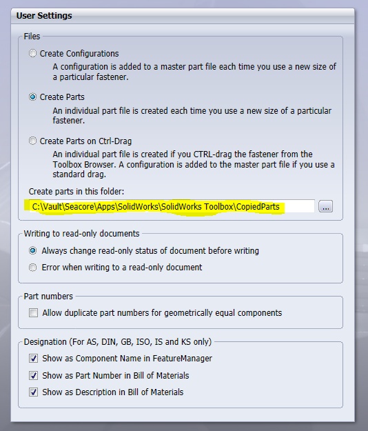

We have our Toolbox set to create parts within the Vault.
Our standard location for Vault views is C:\\\\Vault - and we have our toolbox set to create folders in C:\\Vault\\Seacore\\Apps\\SolidWorks\\SolidWorks Toolbox\\CopiedParts
The problem is, some of my collegues Vault views are located in a different places on their local drive such as C:\\Vault\\JS\\Seacore\\Apps\\SolidWorks\\SolidWorks Toolbox\\CopiedParts
When this happens, the toolbox automatically creates the folder structure it is missing and the user toolbox parts are created but stored locally on their machine

Unfortunately - SolidWorks Toolbox won't allow me to use such a link within 'Create parts in this folder' field
Does anybody have any ideas to remedy this?
