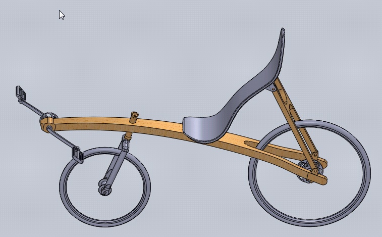

Im designing a plywood recumbent bike frame, see attatched pictures for details, and i want to flatten the frame in order to transfer the design onto a sheet of plywood.
Im going to build a jigg, steam the pre-cut plywood sheets and glue them under pressure to form the frame, so i need pretty exact blueprints.

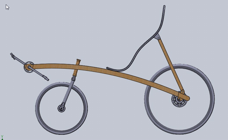

the frame is pretty much a arch, viewed from the side, with a radius of about 2700mm but the top view is  more complex, with a bunch of important mesurements.
I have found a number of tutorials to unfold a sheetmetal part, but im unable to convert my part since i designed it in the "wrong" way.
it is an extruded boss, on right plane, then boss-cut from top to shape it into a bike frame.
im sure i cound figure out a way to sketch the design manually on the sheet, but it would be so much easier if i could print the actual design and transfer it onto the plywood.
What i need is a flat surface extracted from the solid part that i can print, the top surface for instance.
or do i have to learn sheetmetal part manufacturing and redesign the bike (again..)?

Can you post your part for us to look at?

Not a perfect solution but I have unfolded arc shaped parts by using an arc length dimension and a radius dimension in the sketch.  Then create 2 configurations where the folded configuration has the desired arc radius and the unfolded configuration has a gigantically huge radius (R1000, R10,000, etc.) so the arc is almost flat.  This technique requires that subsequent features be defined perpendicular to the arc so that when the arc has a large radius (flattened) those features are unfolded also and are positioned correctly.
SF
SF 2013-09-10
First,
If you go back into the cut that defined the outside edges of your and tell it to do a "Normal Cut", then you may be able to use the sheet metal features. That may not work if you need the sides to be at an angle to the top face instead of being perpendicular.
