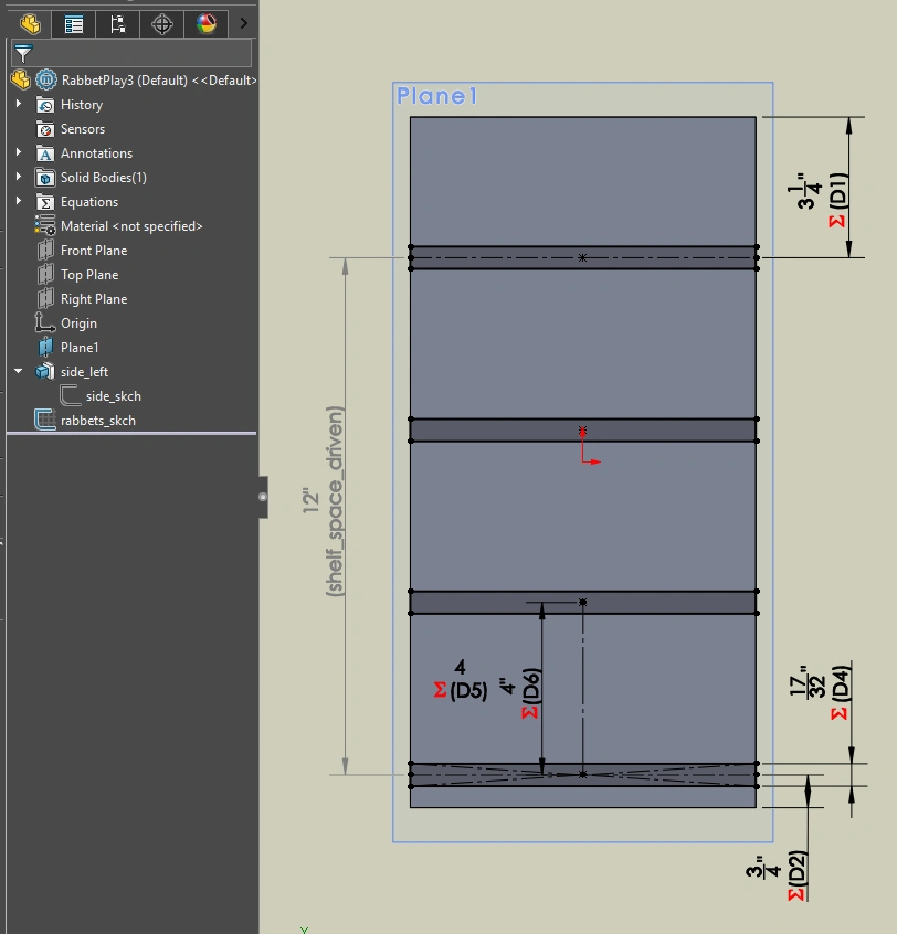

Unexpected "Potential Circular Reference" in Equations
As an example, shelves are mounted into a side board using rabbet joints. The number of shelves and the height of the side are configuration dependent. This seems to be done straightforwardly with a linear pattern leveraging a driven dimension to control the shelf spacing.

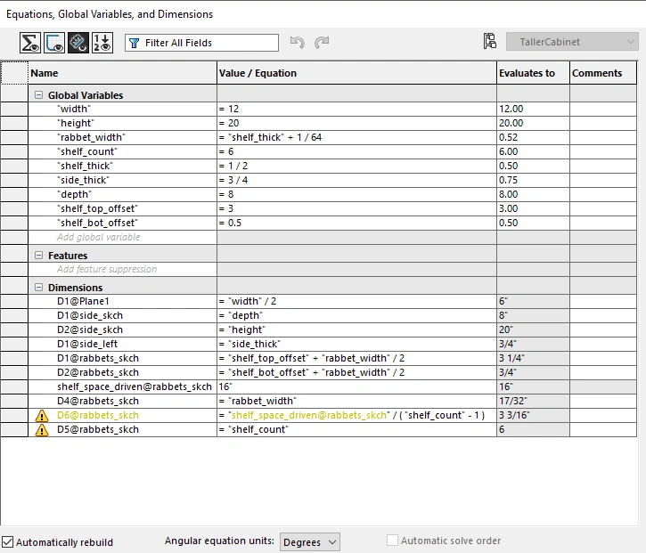

The question is why does the Equations dialog show potential circular references, and it also turns off "Automatic solve order"?
The sketch responds properly to configuration changes like number of shelves, top and bottom spacing, and height of side, although with some changes the rebuild button needs to be clicked to get the display updated.
It seems clear there is no circular reference, so why mark it as a concern?

Remove D1, it is not useful if the shelf_count changes.  Change D6 to be = ("height" - "shelf_top_offset" - "shelf_bot_offset") / ("shelf_count" - 1).

Agreed there is another way, but mine was an example of using construction geometry and a driven dimension for clarity. The question is why does Solidworks think there is circular logic in the equations when there is not. In a more complicated case a warning like this would take more time to disprove. Why is this warning not simply a software bug?

A driven dimension is by definition redundant. The question is about why circular warnings are produced. D6 is just a convenient way to refer to a known value.
