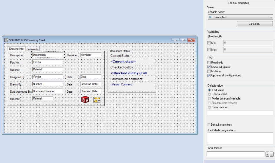

I am having a issue where the drawing sheet does not link to the data card. I am using configuration specific properties to link the property name. I have made a sldprt data card and it works without any issues but not the slddrw. What could be the issue?

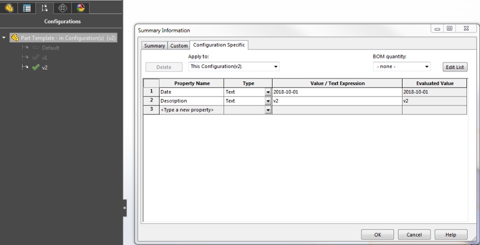

Image 1 - Property Table. Each Configuration has a specific name. (please ignore any other property name)

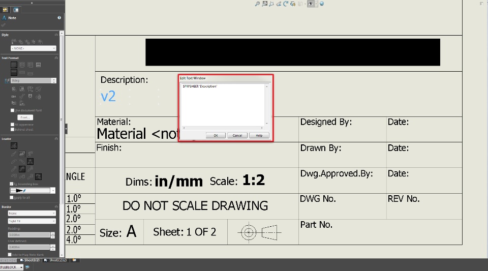

Image 2 - Drawign Sheet. I have linked to \\\$PRPSHEET:"Description" to the text box. (I also tried \\\$PRPSHEET:{Description})

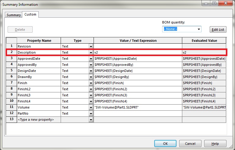

Image 3 - Summary Information in the drawing sheet. I have tired \\\$PRPSHEET:"Description" and \\\$PRPSHEET:{Description} (please ignore any other property name)

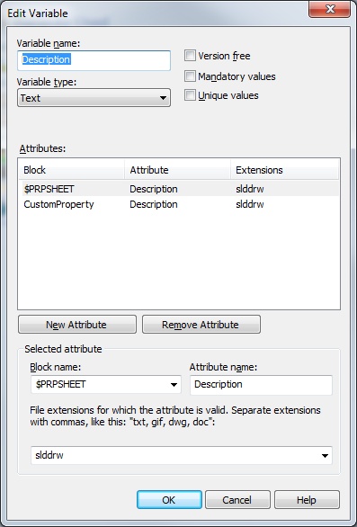

Image 4 - Variables set (same variables for the sldprt)
Image 5 - Drawing Card

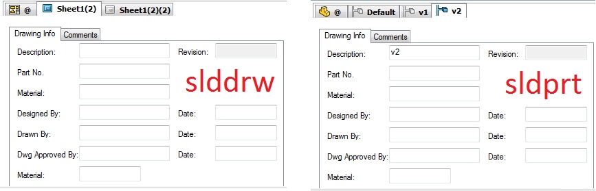

Image 6 - What it shows in the pdm vault. The variables works for sldprt but not the slddrw.
I am not exactly sure why this is not working. In PDM, I have set unchecked the @ configuration and checked the set focus to  active configuration.
