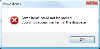

I have been moving files from a quaratine area in the vault to their final permanent home after cleaning up custom properties and such.  I have a handful of assembly files that refuse to move.  Any attempt yields the following error:
A check of the log file shows this:

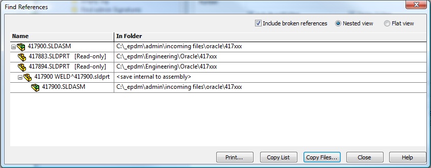

The files in question have one thing in common.  They all contain a virtual component with in-context references to the top level assembly.  An example set of references looks like this:

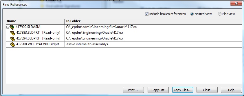

I figured that the circular reference was causing the problem (especially since the SQL error mentions recursion), so I deleted all the in context references and the In-Place mate so that the tree looks like this:
The error remains and the file will not move.  I have also tried saving the virtual component externally, but the error still occurs.
