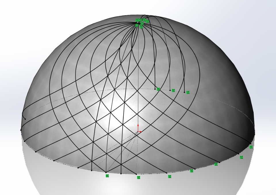

I thought the best way to make something like this would be to make a 3d sketch of one set of ribs as a path for a swept boss/base and then to mirror and circular pattern that sweep to get a full dome.
I created a 3d sketch with a raster wrapped over a half sphere by making intersection curves between a swept helical surface and some planes with the half sphere:
I thought I would be able to now make a new 3d sketch, insert the converted entities I need from the 3d sketch pictured above and simply cut away any lines that I do not need. I planned to then be left with only the lines I indicated in red in the picture below, which i can then use as a sweep path to create a line of connected ribs that I can mirror and make a circular pattern out of to complete the dome lattice.
However, SolidWorks is not cooperating with this step at all. I can start cutting lines, but apparently SW does not see most of these lines to be intersecting and clicking a line segment to cut removes a lot more than the single bit I'd like to cut. Sometimes a complete line is removed and sometimes the distance between two or three intersection points.
What would be a good solution to this? How can I end up with just the line segments I indicated in red? And is there perhaps a far easier/better way to get to the result I want that I should try instead? I have attached the SW file that these screenshots are of to this post, in case someone wants to give it a go.
