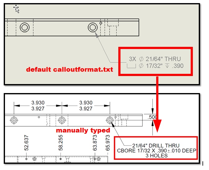

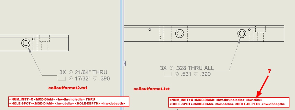

I would like to edit the calloutformat.txt file so holes like in IMAGE 1 (below) have text describing the hole type versus symbols. I am trying to make sense of the calloutfomat.txt file. In our default folder, we have a calloutformat.txt and a calloutformat2.txt. I started playing around with each of them to see what the differences are. As you can see in IMAGE 2 (below), its the same hole, different callout format. What I am trying to find is what controls the variable
Does anyone have a tutorial or guide on how to customize the calloutformat.txt ?
IMAGE 1
IMAGE 2
