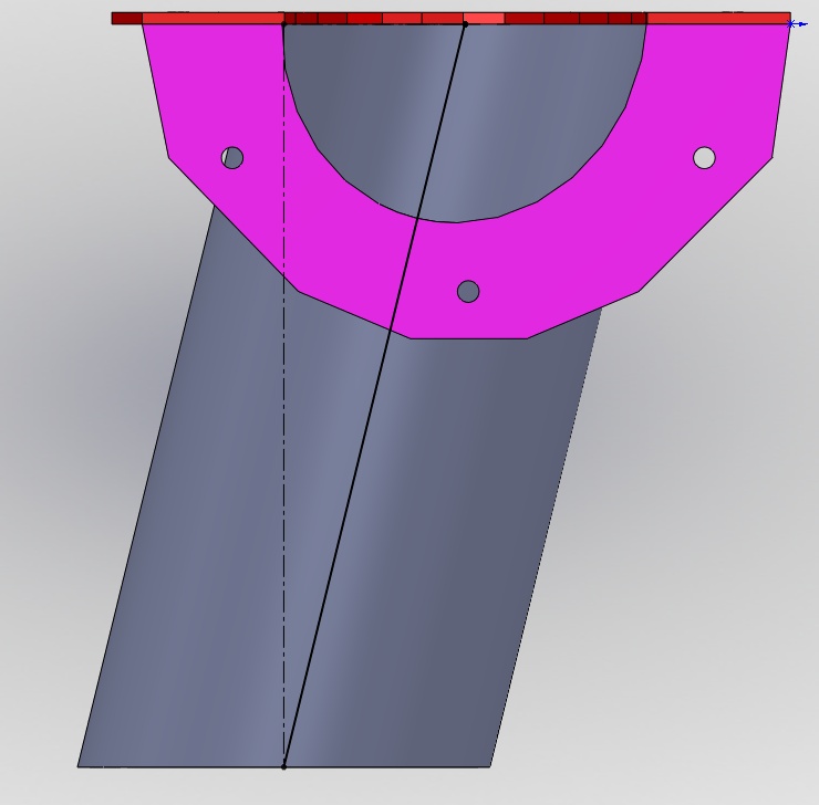

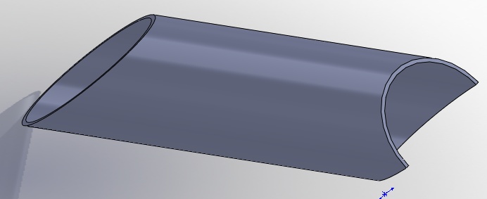

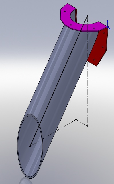

I've reached a stumbling block with my part in the procedure for trying to get one of the solid bodies converted into a sheet metal part so I can flatten it. Please see the sketches below for clarity. The gray pipe needs to be hand-burned in our shop as the miters are compound and too steep for our saw. I've developed paper wrap-around templates for pipes in the past but those were all for simple cuts, this one is complicated as it kicks 2 ways and I'm no expert in this area.
I tried using "insert into new part" as well as "save bodies" after picking the pipe but not sure how to develop a reference plane so I can draw a line on the top surface of the pipe (say top quadrant). The problem is trying to get a line on the top quadrant of the pipe that I can offset then trim out (to get gap which is necessary for sheet metal development I think). I used a 3d line to get pipe at the correct angle so the pipe centerline is not parallel to any of the 3 planes and I tried picking points of the elliptical profile to develop a plane, but no luck. I've attached the SW2010 part files also for reference (main part file and the "save bodies" one). Any advice? Thanks in advance!
