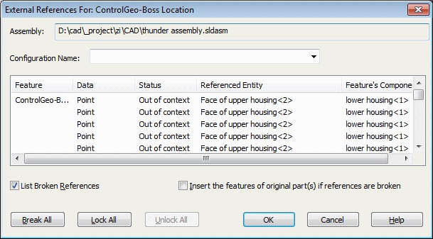

Once I open the main assembly and do a File > Find References there is one file that is not found. That file is the main assembly. The main assembly was renamed. How do I find which part has the reference and just replace "Old Name" with "New Name"?
I'm assuming the reference is to "M-021". If I open that file, I see the same Grayed Out reference, but none of the external references in the File Manager point to the assembly. Well, sort of. I can show a RMB > List External References on the feature "Boss Location" and see the reference is to a part in the assembly "upper housing" that is now out of context. That part has also been renamed.
I can File > Open the "M-021" part with "References" and point to the renamed top level assembly, which works, but back inside the Feature Manager > List External References it now lists the new assembly at the top, but still points to the parts with the old names. That will address the "File Not Found" issue above, but not the references.
At this point I am not sure how best to fix this, besides editing the sketches with the references, finding all the referenced entities, deleting them, opening it up in the new assembly and reselecting "collinear" "coincident" etc to references in the renamed parts in the renamed assembly, That gets a little gnarly, but works.
