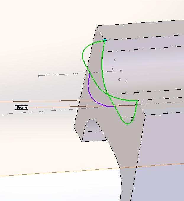

Hello Forum I am using SW 2014. I am trying to create a finished end on a routed shape/profile. I have created a plane on the top surface of the shape and a guide profile but every time I try to create a lofted shape I get a Blue Circle at one corner of the shape? I have created a relation of coincidental but it does not seem to work?
All I want to do is finish the end with a sweep of the cut profile, up to the top surface of the part.
