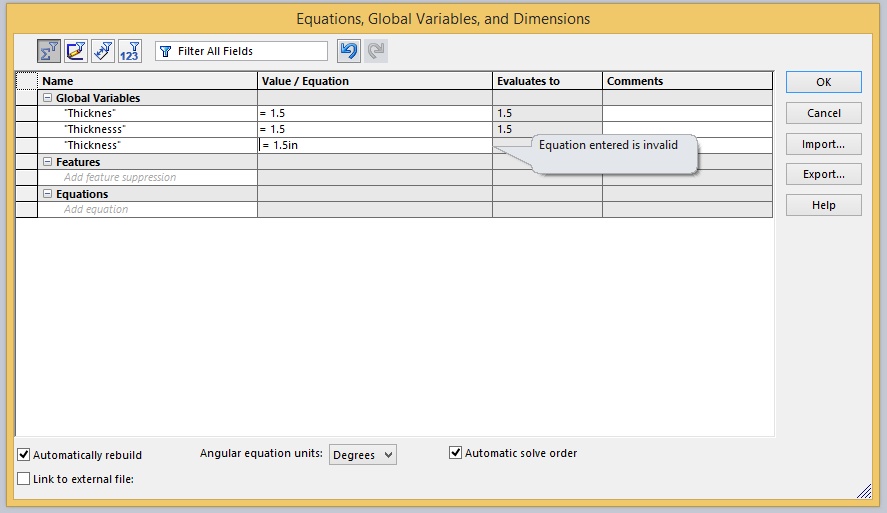

I'm having trouble creating a Global Variable named "Thickness"

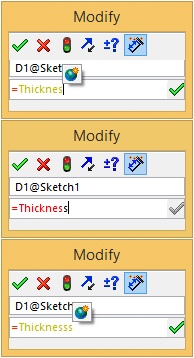

I tried deleting the files associated with the problem, and restarting Solidworks and creating a new Part file with a single sketch containing a rectangle and only one Dimension, and the attached picture shows the result. "Thicknes" and "Thicknesss" do not cause the syntax error in the Equation Manager, only if it is spelled "Thickness" does the error appear.
