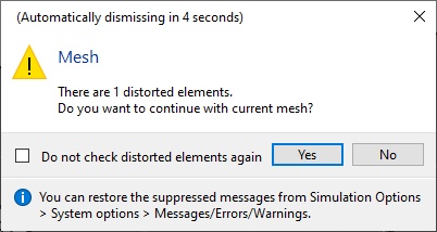

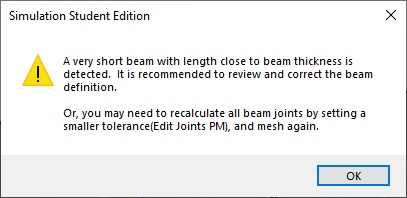

I am doing an assembly of a tube frame supporting solar panels. When I try to mesh the assembly with the standard mesh tool i get a error message.
choosing yes or no outputs a mesh model that is incomplete with the error message.
I do not know what part of the assembly is causing this, I have enclosed a pack and go zip file of the assembly.
