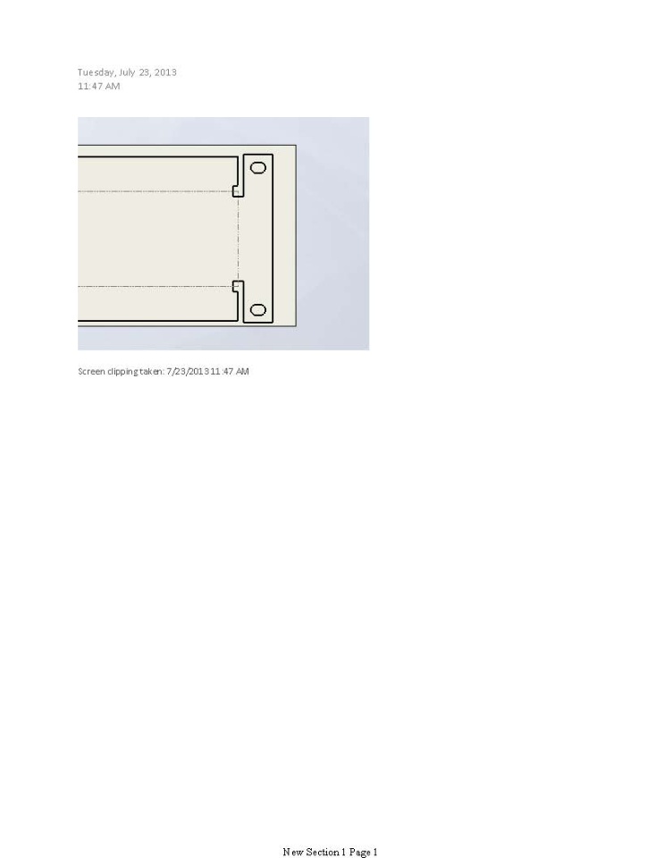

We have recently added a press that can bend our material off the drawing. Now we have run into the issue where the bend lines extend off the edge of the part as shown below. For some reason this throws the CNC press into a tailspin and it can't work. We have tried to trim the bend lines as well as attempting to select them and pull the points to the part edge, all to no avail. Does anyone have any suggestions on how to make the bend lines terminate at the part edges? We are now looking at hiding the lines and drawing in new ones by hand.
Thanks
Jim
SW 2012
