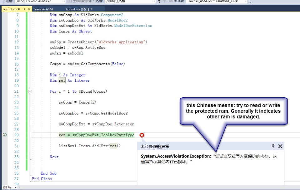

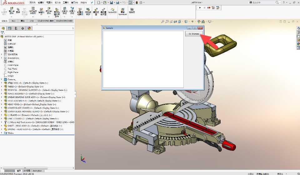

I am trying to program a exe to traverse the assembly design tree. However, when I try to filter the part that is toolbox type, it could not run and pop out the error message as below screen capture indicate:
I attached the sample project of VB.NET and source code, and pls help to give some advice. thank you.
