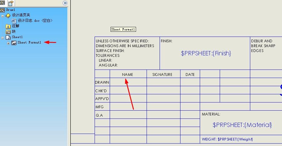

Traverse the Note in Sheet Format?
Sub llll3()
  Dim SwApp As SldWorks.SldWorks
  Set SwApp = Application.SldWorks
  Dim SwModel As ModelDoc2, SwDraw As DrawingDoc
  Set SwModel = SwApp.ActiveDoc
  Set SwDraw = SwModel
  Dim SwView As View, kk As Integer
  Dim SwNote As Note
  Set SwView = SwDraw.GetFirstView
  Do While Not SwView Is Nothing
     Debug.Print SwView.GetName2
     Set SwNote = SwView.GetFirstNote
     Do While Not SwNote Is Nothing
        Debug.Print kk, SwNote.GetName & "@" & SwView.Name
        kk = kk + 1
        Set SwNote = SwNote.GetNext
     Loop
     Set SwView = SwView.GetNextView
  Loop
End Sub
Result is
0            DetailItem1@Sheet1
1            DetailItem2@Sheet1
2            DetailItem3@Sheet1
3            DetailItem4@Sheet1
4            DetailItem5@Sheet1
5            DetailItem6@Sheet1
Sub lllfff()
  Dim SwApp As SldWorks.SldWorks, SwModel As ModelDoc2, SwDraw As DrawingDoc
  Dim SwSelMgr As SelectionMgr, tmp, Str
  Set SwSelMgr = SwModel.SelectionManager()
  Str = "DetailItem16@Sheet1" → don't Select Note
  tmp = SwModel.Extension.SelectByID2(Str, "NOTE", 0, 0, 0, False, -1, Nothing, 0)
  Debug.Print tmp→ result is False
'recodr Macro result is
  Str = "DetailItem50@Sheet Format1"
  tmp = SwDraw.Extension.SelectByID2(Str, "NOTE", 0, 0, 0, False, 0, Nothing, 0)
  Debug.Print tmp  → Result is True
End Sub
Help me,Traverse view in Sheet Format1→
        kk = kk + 1
     Loop
How to SwView.Name  →       Str = "DetailItem50@Sheet1" (View name is Sheet1)
   → Str = "DetailItem50@Sheet Format1" (Viewname is Sheet Format1)
Thanks.
