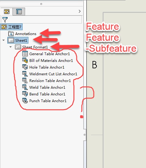

Hi Guys,
when I use VBA Macro to traverse the drawing feature tree, I found the anchor feature that under the "sheet format" could not be read.
what are these object called in SW Drawing API ?
as the picture shows, we know the feature, subfeature, then how to call the anchor ones below "Sheet foramt"??
