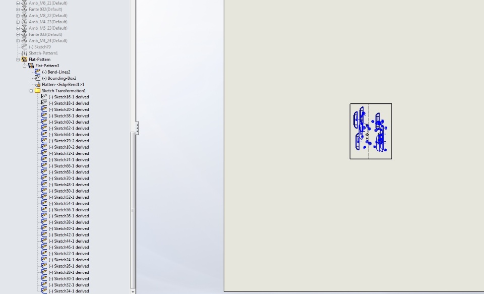

Hi,
I want to hide all derived sketches!. I attached the code that read tree... i try to hide sketches but....error!
thanks!
