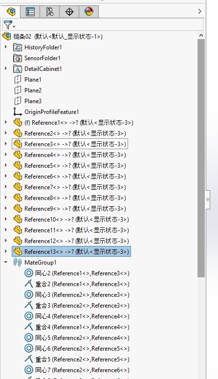

Translate the feature tree of an Assembly
I am currently translating some SolidWorks files from Mandarin to English, and the code that I have will translate everything besides the names of the mates; I was hoping somebody could show me, what I will have to add to the code or if there is another code outer that does the same thing?
