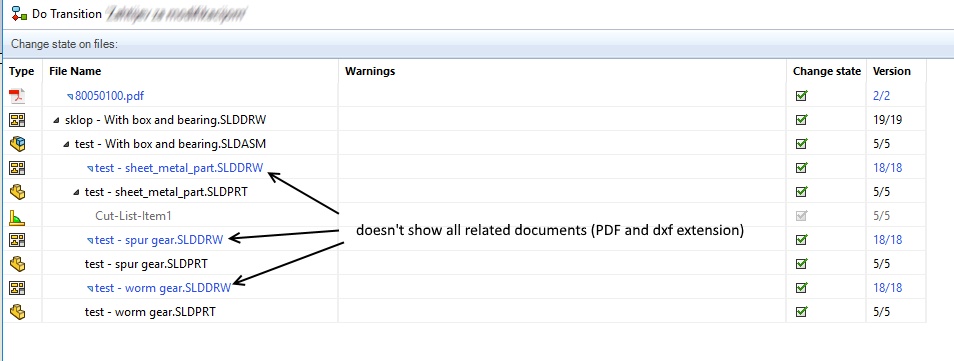

I make transition of a top assembly drawing to Released state and in that state PDF and DXF will be automatically created for all related drawings.
Everything working fine until I need to change state from "Released" to "Under modification".

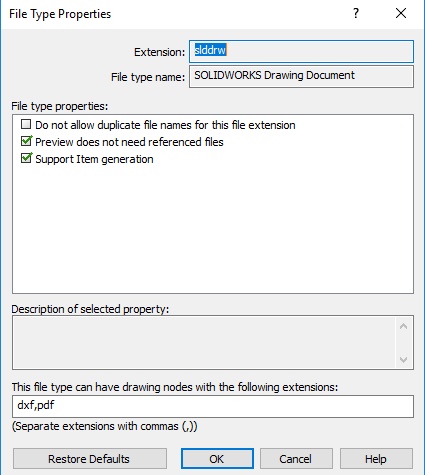

When I make transition from "Released" to "Under modification" I would like that all non-cad documents goes to transition - not only PDF from top assembly (see picture below).
In File type i have put dxf and pdf.
Is it possible to see all related documents (non-cad files) for a top assembly?
How it's possible to achieve that all related documents goes to transition?
