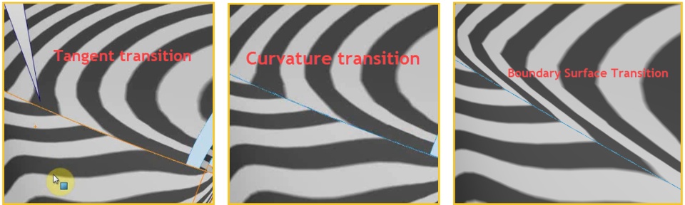

A regular spline has G2 relation between two surfaces. Using this spline and surface fill, a surface was created but neither tangent relation nor curvature relation with the particular edge gives smooth transition. What is the reason for that?
Boundary Surface also tried but no use.
