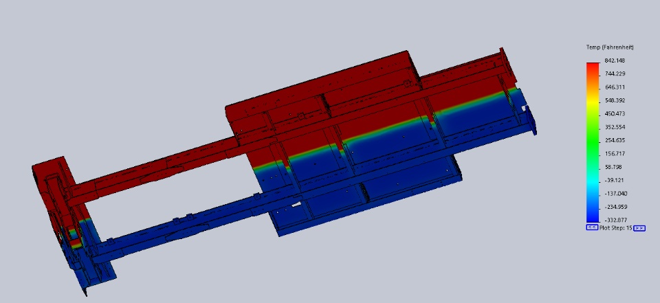

I am working on a thermal simulation where half of an object is submerged in hot fluid and the other half remains exposed to a cooler fluid (air). I am assuming that prior to exposure to the hot fluid, the object is at steady state. The analysis is transient.

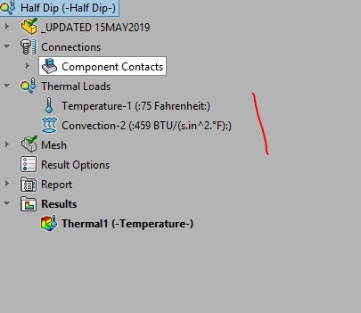

Thermal Loads:
Temperature: Initial = 75F on all surfaces
Convection: h = 459 and T = 842 on half the object. (I used a split line cut the object in half)
Somehow, the "cool" side drops to -333F. With no convection, this side should not drop below 75F. I had assumed that SolidWorks treats undefined boundary conditions as insulated.
Note: You can see that there does seem to be an appropriate gradient between the two sides of the object.
See photos; thanks in advance.

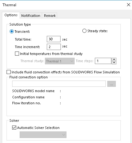

Daniel, I solved this problem. Run the study as a steady state problem that would result in the temperature you want to use for the initial temperature in the transient study. Then, when you set up the transient study (in the Study Properties), check the box to use the initial temperature from the steady state simulation. Make sure you select the correct study in the drop-down menu. It is important to note that the steady state and the transient studies must be exactly alike, except where the thermal loads are concerned. After that, I no longer got nonsense temperatures and it passed the sanity check.

UPDATE:
Looks like the simulation got better results after I selected the seed propagation. Still showing a negative temperature and I'm not sure how to explain a temperature above the bulk ambient temperature. I increased the step size from 2 to 5 over 30 seconds.
Thermal Loading is:
Temperature: Initial = 75F on all bodies
Convection: Bulk Ambient is 75F on the "cold" side and 842F on the "hot" side.
A basic understanding of heat transfer would indicate that the maximum and minimum temperatures should be between 75 and 842 degrees for the given boundary conditions.

Thank you for the reply Steven,
The Bulk Ambient Temperature is specified as 75F for the cool fluid convection side and 842F for the hot fluid convection side. The initial temperature for all faces is set to 75F.
