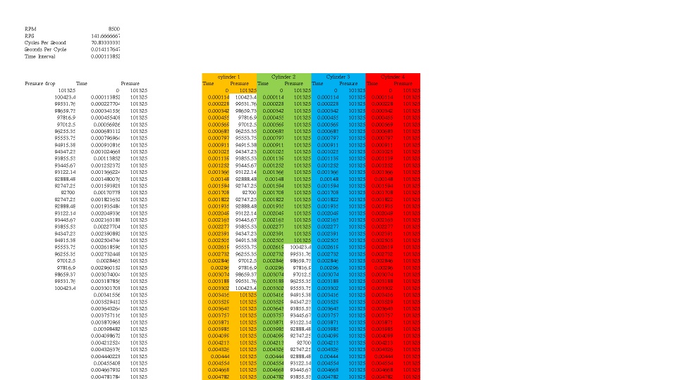

I have an Engines Intake and setup an excel file to show the pressure changes(attached)
