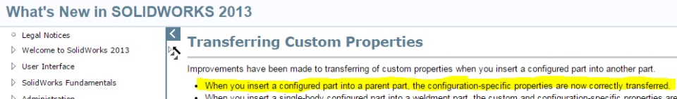

I wasn't quite sure where to ask this question, it's seem's to have been covered in the past but I couldn't find a solution,, other than this terse yet sanguine note in what's new in 2013

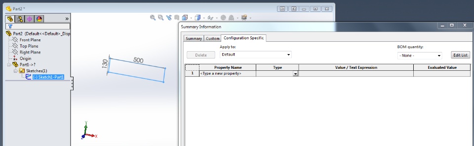

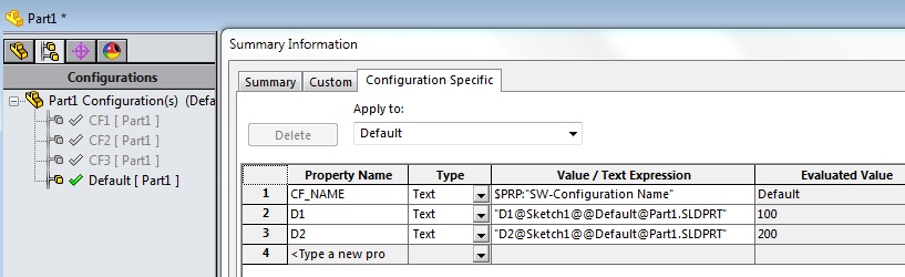

- Here's my example properties, this seems to work fine

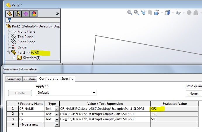

- When I insert the part and transfer custom properties, the configurations don't match

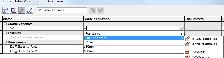

- The properties are available in the flyout menu

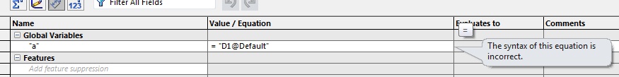

...but they cause a syntax error if you try and use them
- and they dont 'stick'
