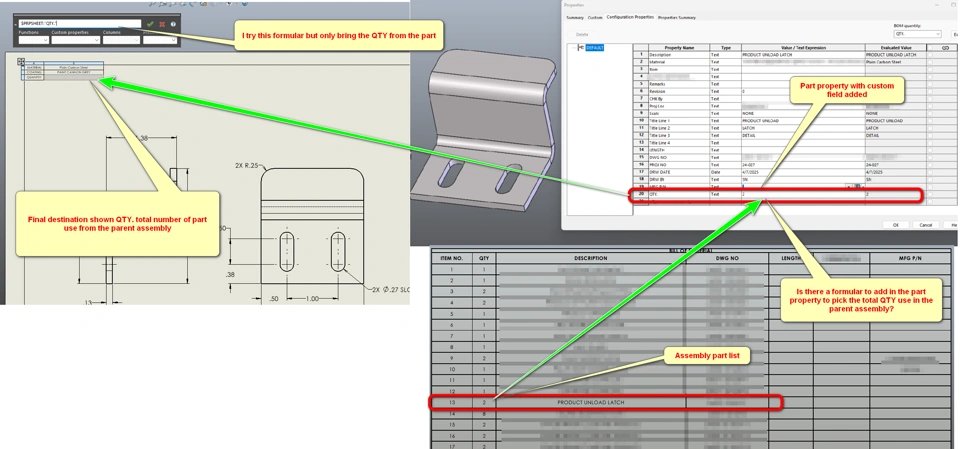

I am new to SW and I currently use SW-2024 SP5. I am looking for an idea or a way to add a custom property to a part so when you bring the part on the drawing detail you can add a notes or table to show the total QTY. of that part use to parent assembly.
Is this possible?
My company like to put the total QTY. on the drawing detail of that part to help the manufacture how many they has to make without look thru the top assembly drawing detail. They use quick table insert in the drawing then they manual type in the QTY. but this could lead to the mistake if you add more part later.
So I am looking for a way to automate this in the part detail drawing how to bring this information up from the parent assembly.
Is there a quick formular to add to the part property?
