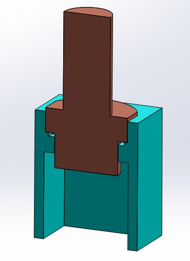

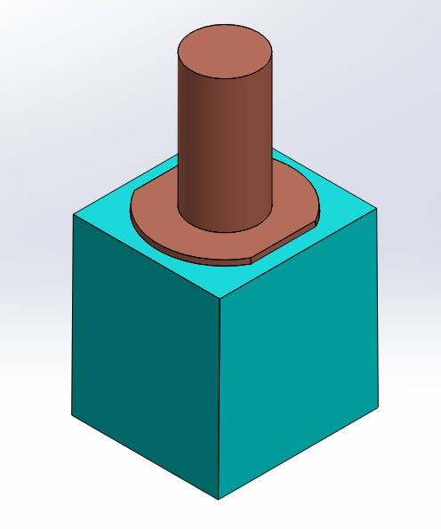

I am trying to run a simulation on this small assembly: a copper stud inserted into a plastic housing (nylon 6/10), with no other restrains. Apply torque on the stud and run the simulation to see how much stress is generated by the stud on the housing.
1. I set a global non-penetration contact

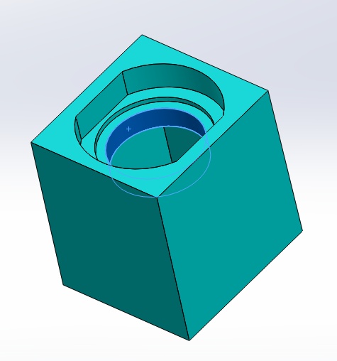

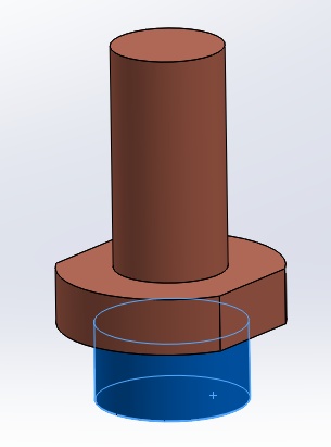

2. these following two surfaces are set as pin connectors

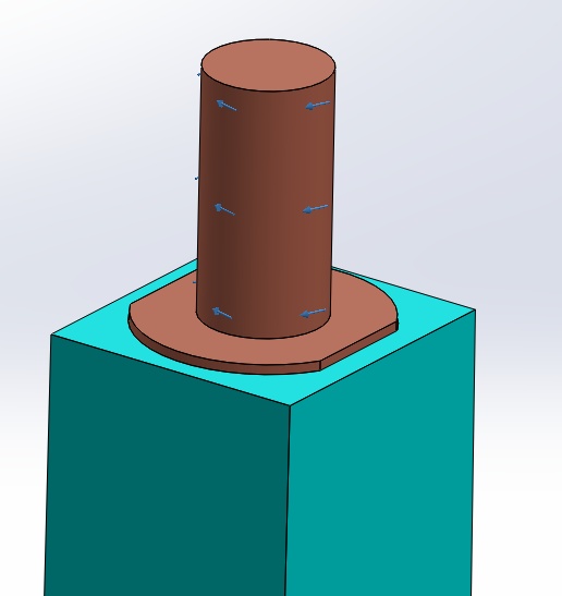

3. 3.5 Nm torque is applied on the stud as:

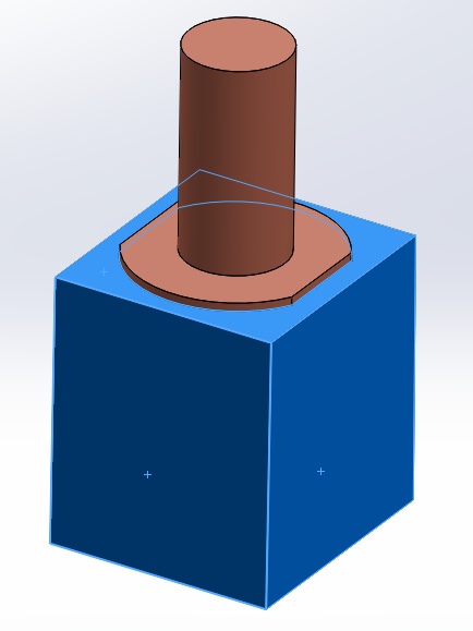

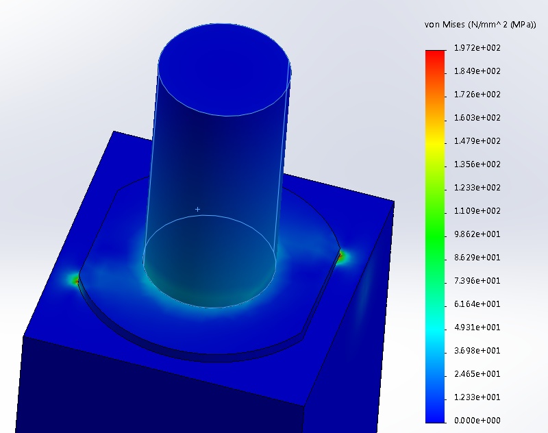

when I set the fixtures like the following (the 4 side surfaces and the top surface of the plastic housing):
I got the result as the following (the max stress is about 197MPa):

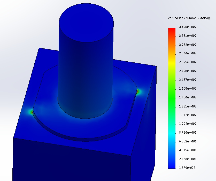

when I fix only the top surface of the plastic housing, like this:
I got the result as the following (the max stress is 350MPa):
which one makes more sense? is there any other problem with my simulation input?
