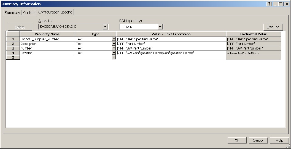

In toolbox i have filled out the property "Part Number" and "Description" thru excell and imported it back in. I can see the "Part Number" gets filled into the ("Part number displayed when used in a bill of materials" "User Specified" under configuration properties.
Because we use a custom property for our part number, these toolbox part numbers come in blank on our BOM. I don't want to change any files we have, because that would be 10's of thousands. I don't want to change our current BOM. Our entire file system, purchasing, ect. uses the custom property to pull info from.
So what i want to do is, have our custom property for "part number" and "description", point to the toolbox "part number" and "description". Something like ("CM_Number"=SW_Part Number") But, i don't know what the property name for toolbox "part number" and "description" is. Does anyone know what properties these are?.
I'm sure the BOM has to pull it somehow with a property/varible, right? So under the toolbox part, under configuration properties, bill of materials options, part number displayed when used in a bill of material, How do i extract that info into our custom property?
And I don't even know where the toolbox description's go!
