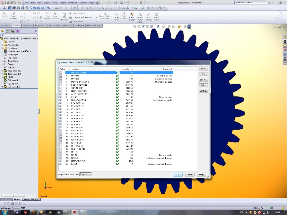

I maded a gear with equations, and uith involute profile ecelent, you can all of you use it, but I want to add it to toolbox, and then in an assembly to add it and when I add it I want to appear the next things to modify my equations: Dd, DC, Df, Di, H, Z, b and t2 values.
Thouse are my equations maded in part, I added tis part in toolbox, and then I selected configure.

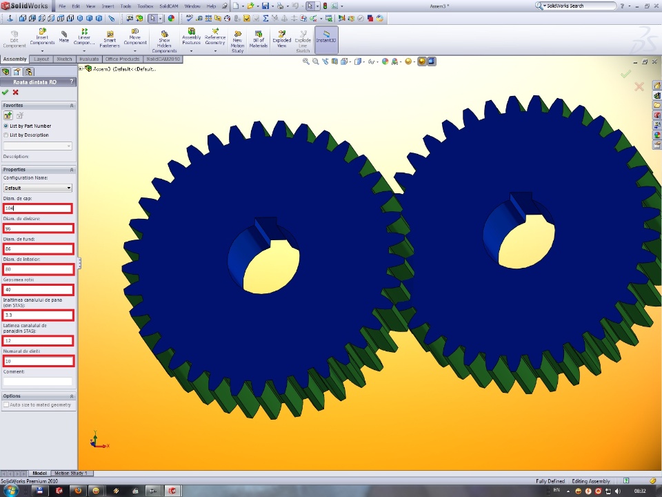

And from there I added custom configurations (in text mode) and in the value box i added \\\$var:Dd \\\$var:Df and so on.
Then I saved my configurations, and when I inserted the part in assembly I had this:
I inserted my desired values and then pressed OK, but nothing happen, my gear remain the same.
Is there any solution to insert values and modify my equations?
