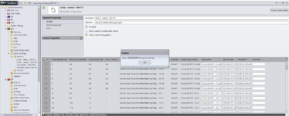

Newly created Toolbox 2019 was set up during installation.
Problem occurs when you export data of a fitting to excel.
Open the excel file and add property columns and import back into toolbox.
All the values have propagated on screen in the toolbox browser opened from within a running SolidWorks session. When selecting "Create Configurations" (as that is the user setting selected in User Settings" within toolbox) the following error occurs. Sequence as follows:
message appears telling me how many configurations it is about to create.
< select OK >
immediately an error message appears
Error, SOLIDWORKS must be running
** SolidWorks is running **
I have had this bug on previous releases as well and think it must a be registry related issue.
Can anyone assist with the fix? Because I get the feeling not many people are using toolbox in this way
