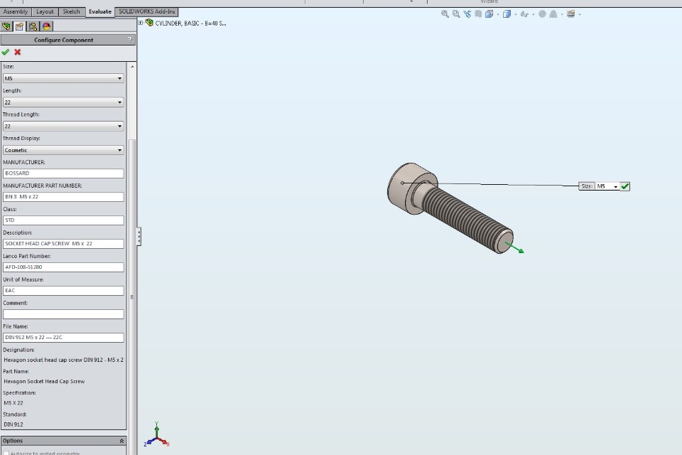

Okay, when I add hardware to an assy using toolbox I get this:
as you can see it is a DIN 912 standard M5x22 Hex SHCS with cosmetic threads turned on.
When I edit the part, and the cosmetic thread feature I get this:
Shouldn't this say DIN standard, Machine thread, and M5?  The reason this is a problem is because when I do an interference check on the assemblies I am working on I want to capture the matching cosmetic threads, but I cant if the specification and the thread are not present in the hardware... I kind of though this is what toolbox was all about.  Instead every bolt in every hole shows up as interference because the cosmetic threads don't actually match...
